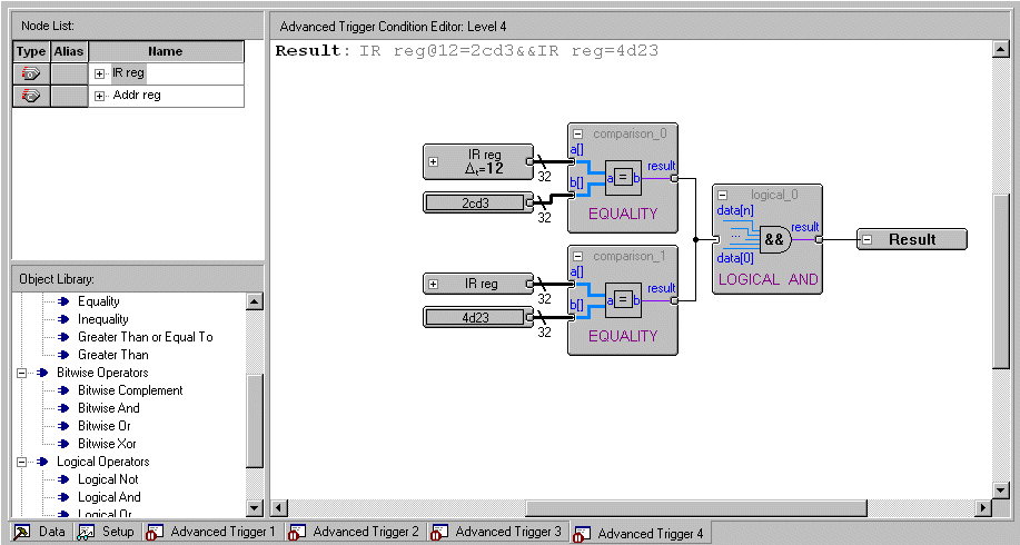

In the following example, the advanced trigger condition uses a Data Delay parameter on a Bus object to delay by 12 clock cycles the value of IR reg before comparing it to the value 2cd3. The advanced trigger condition triggers only when the value of IR reg is 4d23 exactly 12 clock cycles after its value is 2cd3.
